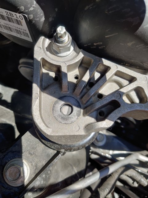

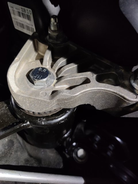

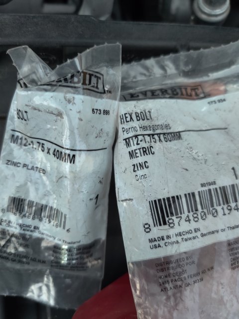

Does anybody know what the bolt size is mine just broke and I need a Band-Aid for my daily driver. I ordered the new one from woosh. But it won't be here for some days and I need to work wondering what the sizes are maybe I can get a bolt from home Depot to hold me over a couple days
3,971
4,065
#31
M12x1.75

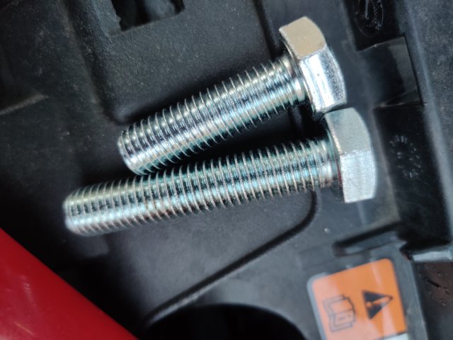

#40
