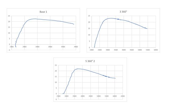

Hi guys! Last week I bought the custom Dizzy Tune and have some power losses. Showing 140HP vs about 180 with Cobb OTS 3 93 OCT. I also got P0420 for Catalyst System Efficiency and P061A for Internal Control Module Torque Performance. Asked Jason wednesday last week with some logs, but he hasn't replied yet. Can you advise on how much should I be expecting to get the revisions? Regards.

Is this your first tune (no revisions yet)? If so power and boost is probably limited to make sure any possible knock or corrections aren't as bad. As you send and receive revisions power will increase as Jason tunes it.

It is the first version. Jason replied me to check for boost leaks, I already tighten everything up and as of me I'm still seeing the same boost. I will take it to a professional for a propper boost leak test. I plan to tell them to test up to 28 psi since I understand Dizzy runs at about 26.

Update on the Dizzy tune. Checked for leaks up to 30 psi, no one found. Already thightened the Wastegate to 3 turns after Jason recommendation, no effect. Did a test with 5 turns instead of 3. Same result. I'm not sure what is going on, probably next step is to replace the valve.
Attached are some boost graphs. Some are a little bit noisy due to being wet and TC acting on throttle. One of the 5 turn runs was offsetted (not sure why) It is the one shown in the pic. The other was practically the same as the one with 3 turns.

The first tune is your base tune that will be low on power and boost. Just relax and Jason will turn it up on power. He responds about two to three weeks after you sent the current map/data log
