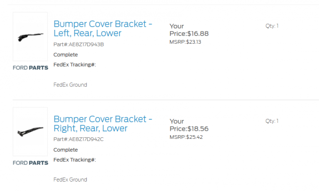

Just removed my rear bumper cover yesterday. For anyone looking to do the same, as mentioned in the video, just get the new plastic brackets that mount to the body. On my 14 (built September 2013), basically all the tabs exploded when I pulled the bumper cover off. Rivets drilled out easy enough, just need a little sanding/grinding to get the rest of them out.
