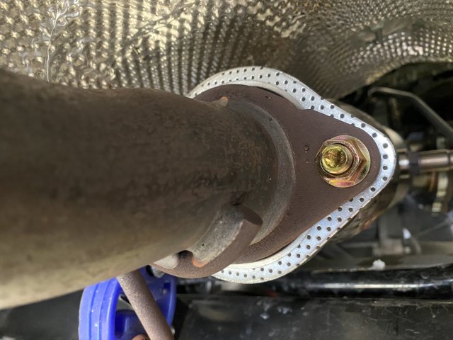

As you can see from the photo above, the gasket doesn't line up with the flange. Obviously a major exhaust leak would occur installing this way.
So then the question came, are we supposed to use the OEM gasket instead? Or are we supposed to use BOTH gaskets? In Ron's statement, its not clear whether he's referring to using the supplied gasket or OEM gasket or both. Well the problem here is that the OEM gasket alone is too thin to cover the supplied adapter ring. (Sorry no pic).
We considered using both gaskets along with the included adapter ring, with the supplied gasket against the adapter ring and the OEM gasket against the stock catback flange. This didn't seem like it would work properly and I was very skeptical of this. The outside diameter of the OEM gasket is barely wide enough to cover the inside diameter of the supplied gasket, which would cause a leak. There's just not enough overlap to be confident in this. (Sorry no pic)
In a bit of a panic I had tried reaching out to Ron, thankfully in emails he provides his cellphone number in his signature, so I tried calling and then texted, he didn't get back to me right away until after we put the car back together.
DECISION: We noticed that the provided adapter ring, when mounted in the Whoosh catback, sits just slightly thicker than the 3" flange and isn't flush. We figured this is to allow it to make a seal by "crushing" the metal adapter ring against the whoosh 3" flange and so we decided our most likely best course of action was to use the adapter ring against the downpipe and use ONLY use the OEM gasket and bolted the catback and downpipe together. (Sorry no pic again! Ugh.)
RESULT: Drove the car home last night and everything seems good so far with this setup (used the provided adapter ring with the OEM gasket, did not use the provided gasket). So far, doesn't seem like there's any exhaust leak, no codes, etc, car feels and sounds great.
